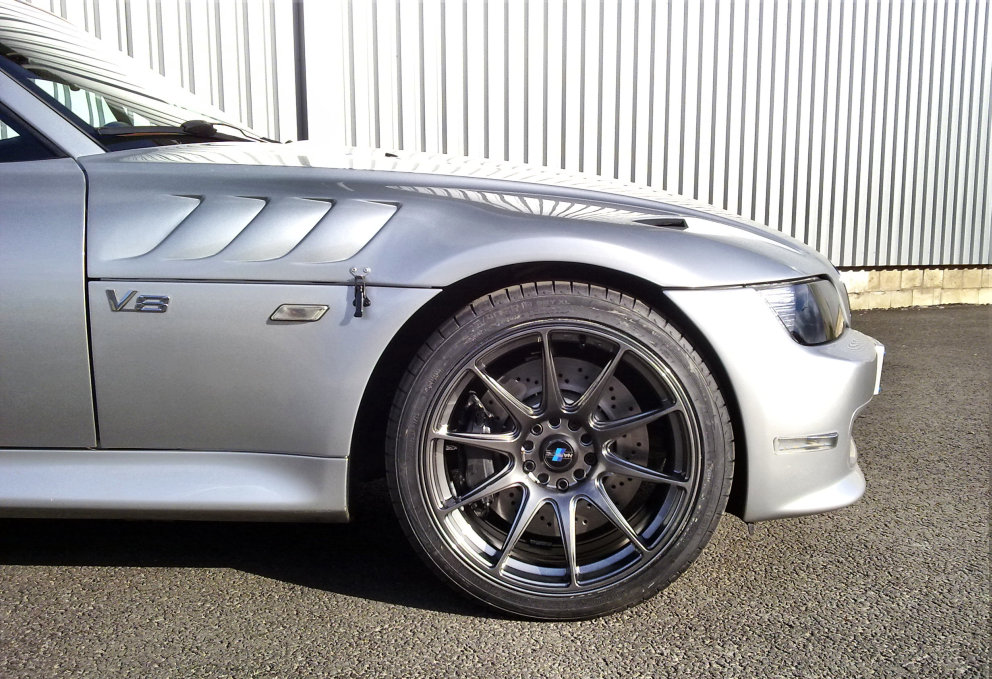

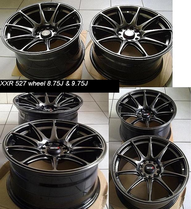

I wanted some change for a while, and I also wanted smaller diameter (outline) tire then was possible with the 19 inch fronts (rear no problems)
specially at the front were the M coupe is 10mm closer to the front mudguard then all other (non M) Z3's (10mm longer wheelbase)
I choose for 18" with other tires, so now the diameter (outline) from the tire is almost the same as the original 17"wheels/tire combo,
so some more space to the mudguard, especially when lowered and when turn in (outside end of tire going forward) on some uneven road.
That way I can put lower (outline) tires a bit like the original M coupe set-up with 17 inch, then those would be perfect.
http://thumbsnap.com/3vJ5huCz" onclick="window.open(this.href);return false;
http://thumbsnap.com/S3NYzTiK" onclick="window.open(this.href);return false;
XXR 527 wheels in black-chrome, see my order>
Type velg: XXR 527 Black Chrome
2 x 18x8.75/ET35/114.3+120x5/BLK CHROME
2 x 18x9.75/ET20/114.3+120x5/BLK CHROME
But keep in mind, those wheels have a 73.1 mm center hole instead of the BMW 72.6(5) mm center hole
that means 0.5 mm difference total, so 0.25mm per side (around) so to say.
There are no spigot? rings that size/small/thin, so I had to think of something, I wanted that filled up, even if it was that small, I don’t like movements/vibrations in the wheels.
I used good Alu tape which they use for central heating venting pipe (heat) and made then in size, say 8<>10mm wide and ? as long for one round around the centre
(do not overlap) so stick on say 3 layers till it is a tight fit for the wheel or spacer (not overlap the ends) rub that very flat, and then you have your very thin spigot 'ring' which works perfect.
Later I thought maybe even better buy some aluminium sheet that is 0.25 mm thick, than cut strips from 8<>10 mm wide and 1 lenght around the baering axle or spacer.

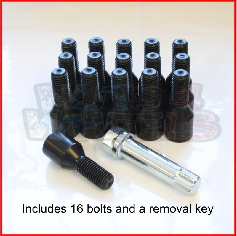

edit to say, with those wheels you need Tuner Bolts, those are more slim and handy, you don't scrape the bolt holes with them (normal bolts wont fit)
tuner bolts like this>> they also can be used as some sort of wheel lock-bolt.
http://i1005.photobucket.com/albums/af1 ... g~original" onclick="window.open(this.href);return false;
The front wheels in the size and ET I ordered, needs no spacers, the rear does with a M coupe, you can go for 20mm per side as 'original' on my Hartge M coupe,
but I found that just a tiny bit to wide because of the wider wheels
and my car also has it there a bit wider, so for a normal M coupe 20 mm is asking for possible rubbing I guess,
so ordered after those 20 mm the 15mm per side, and those are good for the rear, I don't like scraping in the wheel arches. (also depends how wide your tires are)
when going over uneven or bad roads
Also ordered new coilover-set with adjustable camber plates and adjustable shock height, so you can make the chocks shorter,
especially at the rear were the wheels drop to far for my liking when you lift the car, so now I can adjust that, without moving/touching the springs/load.
And to ad something I forgot to tell about the wheels, those XXR 527 are lighter as well,
here my measurements.
Hartge Velg 8J en ET40 in 19" = 12 kg (used with 10 mm Hartge spacer)
Hartge Velg 9.5J en ET22 in 19" = 12.8kg (used with 20 mm Hartge spacer)
XXR 527 Velg 8.75J en ET35 in 18"= 9.5kg
XXR 527 Velg 9.75J en ET20 in 18"= 10kg (used with 15 mm H&R spacer)
Hartge velgen = 49.6kg & XXR 527 velgen = 39kg so I saved on the wheels alone 10.6kg
so thats 2.65 kg per wheel/side for a better unsprung weight.
On the tire combo I saved also a bit, all in all (wheel/tire) precise 3kg per side unsprung weight,
so I was quit pleased with the result all in all, also the Nokian zLine are really good,
especially for the money, they are also pretty wide,
say their 225 wide is the same as say 235 wide from Dunlop Sport/Michellin Sport/Falken Sport/Continental sport 5P I had,
and some others perhaps who are 225 in the real world, those Nokian are what they say,
instead of calling/naming it the 235 tires I mentioned above, what stands on the tire and what they sell those for,
when you measure them they (most) are 225mm and not the promised 235mm.
I have from those ‘wide’ tires on those XXR wheels
front Nokian zLine 225/40 ZR18 92Y XL (So)
rear Nokian zLine 265/35 ZR18 97Y XL (So)
Also very good grip those Nokia zLine, so would I buy those again when needed, sure.
of-course when going from 19 to 18 the side walls are a bit higher, but ad a bit more air
and then they are very good to live with me thinks.
I guess those tires will also be very good on 19"giving also still a bit comfort, so when
the conti sport 5P on my Hartge wheels are worn, I also put Nokian zLine on those.

misschien ook handig voor lezers hier, legt ook het verhaal uit van het BMW naafmaat 72.6 ( of 5) mm naar de velg maat 73.1 mm
en hoe dat het beste te overbruggen, vanwege dat er geen 0.25 mm (per side ring) dikke spigot rings zijn.
Het kan heel goed met CV aluminium afdichtplak spul, maar dan moet je zo’n 3? (vergeten) laagjes plakken (naad tot naad en niet 3 rondjes zeg maar)
maar later bedacht ik me, je kan aluminium plaatwerk kopen van 0.25 mm dik, dan hoef je alleen een strip van zeg 8<>10 mm breed te knippen en
een rondje rond de naaf drukken om zo een soort spigot ring te maken.
afijn, hier het verhaal ff wat ingekort ahum>>

Mooi uitgebreid verhaal. Ik heb alleen niet gezien hoe je 114.3 steek nu hebt pasgemaakt? Mijn voorkeur gaat wel uit naar een gelijk perfecte fitment zonder bijv alu tape oid.
Wel mooi van deze velgen dat je geen spacers nodig hebt aan de voorkant voor de remmen. Ik heb precies diezelfde remmen hier klaarliggen voor mijn Z en wilde dus die Apex Arc8 kopen (17x9j et30) wat net zou moeten passen mits deze velg past zonder spacers. Helaas kan ik daar geen uitsluitsel over krijgen dus durf ze niet te kopen haha.
Enige wat ik persoonlijk jammer vind aan dit soort velgen is dat ze geen velgbed (of lip, hoe ze het ook noemen) meer hebt. dat accentueert normaal wel wat extra breedte van de body van de Z3 coupe. de styling 32 en OEM M coupe velgen hebben dit ook
Re: Z3 coupe S65 met 6-handbak e.d.
Is gewoon 5 x 120e30touring1990 schreef:Mooi uitgebreid verhaal. Ik heb alleen niet gezien hoe je 114.3 steek nu hebt pasgemaakt? Mijn voorkeur gaat wel uit naar een gelijk perfecte fitment zonder bijv alu tape oid.
het is dubbel uitgevoerd, die 114.3? gaten heb ik een bmw rubber afdekdopje in gedrukt, paste perfect (moest er wel ff voor zoeken maar blijven nog zitten ook)
en het lijkt best breed vooral achter, zal kijken of ik nog een foto heb waar je dat wat op kan zien, oke beetje kleine foto, maar het loopt vanaf de naaf naar buiten wat een best dikke uitstraling geeft, tis niet plat/vlak zeg maar.
en ja...als je kijkt naar die 345 mm schijven en de 18 inch velgen...met nog zoveel ruimte, zou je bijna denken dat sommige 17 inch misschien zouden passen...
maar dan nog, dan belemmer je wel wat de koeling zeg maar (lijkt me) ik heb geen 17 inch liggen om het te proberen en ow, die auto ook niet meer.
kijk, bij deze zit ook op FB maar ik heb gewoon via zijn zaak besteld na eerst Internet te hebben afgespeurd en die velgen tegenkwam, toen NL leverancier opgezocht en hij kon ze wel regelen>>
De Hartge staat er ook tussen bij de foto's en ook wat gegevens, ff scrollen tussen foto's 2013
https://www.facebook.com/maicos.nl/photos_stream" onclick="window.open(this.href);return false;
staat trouwens ook wel in mijn verhaal hierboven
hier nog foto met bmw nummers voor die dopjes in de 114.3 gaten
en hier kun je een beetje het diepte verschil zien van mijn velgen destijds

Thanks! Zo zie je inderdaad dat ze duidelijk naar binnen lopen (het hart van de velg). Beetje het concave idee zoals op bijv m359 styling etc. Die Apex velgen die ik had gezien hebben wel een barrelclearance van 355mm bbk's met 17 inch velgen dus dat zou heel mooi "vol" moeten staan met 345mm remmen op de vooras. Daarnaast zijn die velgen dacht ik +- 8 kg voor de 17x9J wat natuurlijk erg netjes is. Ik rij enkel op straat waarbij het minder goed merkbaar is maar ik vind het ook gewoon mooi vanuit performance oogpunt gezien om een mooi product te hebben
ah idd concave meer, was me weer ontschoten.
dit soort oid?
vind ik ook mooi en als ze ook nog zo licht zijn een dikke plus
zag zulk soort een tijd terug op FB bij de M coupe club, ook mooie foto, maar voor het idee
of dit type

Waarom geen set Style 32 in 18 inch?e30touring1990 schreef:Mooi uitgebreid verhaal. Ik heb alleen niet gezien hoe je 114.3 steek nu hebt pasgemaakt? Mijn voorkeur gaat wel uit naar een gelijk perfecte fitment zonder bijv alu tape oid.

Heb ik idd ook naar gekeken in 18" voor een mooie OEM look. Echter zijn deze in 18" alleen geleverd voor de e39 en e38 als ik het goed heb en hebben deze ET waardes van respectievelijk 20 en 22 in breedset vorm. voor de achterkant zou je hier nog wel mee wegkomen maar ET20 aan de voorzijde van een Z3 met 8,5J velgbreedte is een no-go tenzij je -3 camber gaat aan de voorkant en de plastic modderkuipen weghaalt.
Tenzij iemand natuurlijk een bevestiging heeft dat dit wel gewoon past maar dat betwijfel ik. If so, meld je graag dan weet ik dat dit ook nog een optie is!
Ik zal je topic niet te veel vervuilen René
- Tim N
- Berichten: 7753
laatste vervuiling
Style 32 in 8x18 en 8,5x18 van E46 kan prima met ET47/ ET50 (eventueel met spacers)

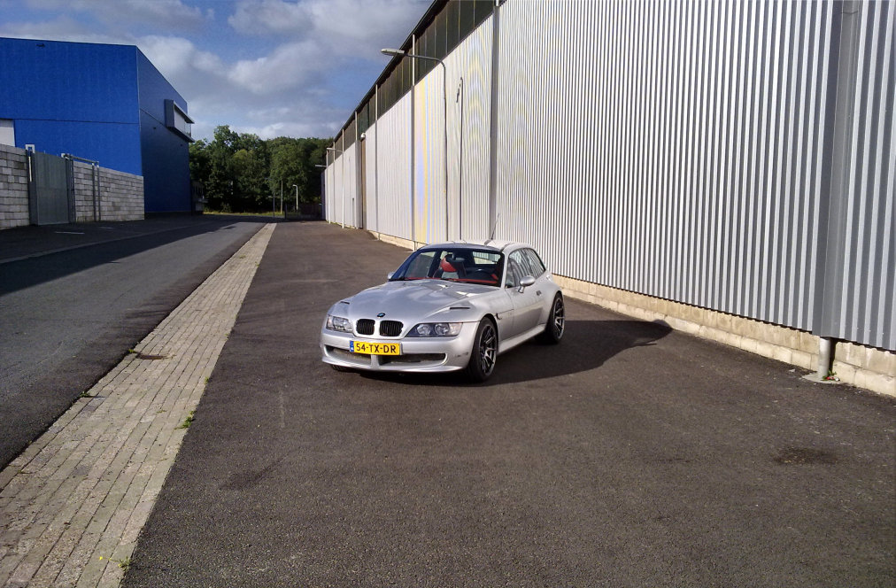

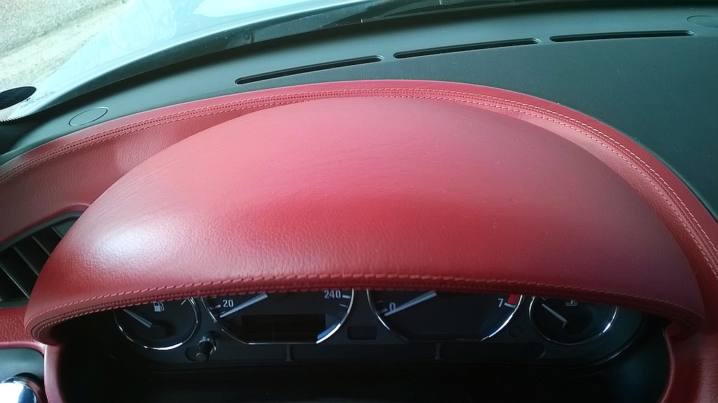

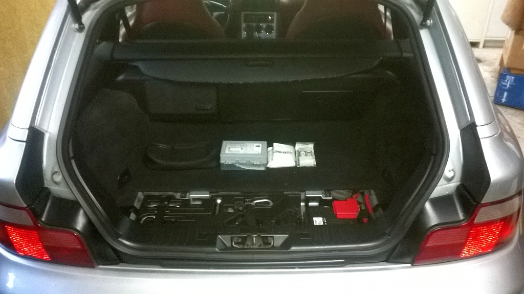

Heb ook nog ff wat kiekjes gemaakt met men foon, niet zo goed dus magoed, mooi ook achterin, moet alleen nog een korte schroevendraaier bestellen, had wel 2 van die dingen maar net iets te lang
maar mooi compleet, zelfs een set lampjes van bmw en zo'n castrol etui wat op de vloer blijft zitten, zit klitteband onder, zelfs een bmw lakstift setje enz enz, alles kompleet op die schroevendraaier na
zit ook een compleet Harmann Kardon systeem in, niet dat ik zoiets echt gebruik magoed.
dat leer is ook mooi gedaan, zelfs het dash e.d. met sticksels
owja die 17 icnh heb ik

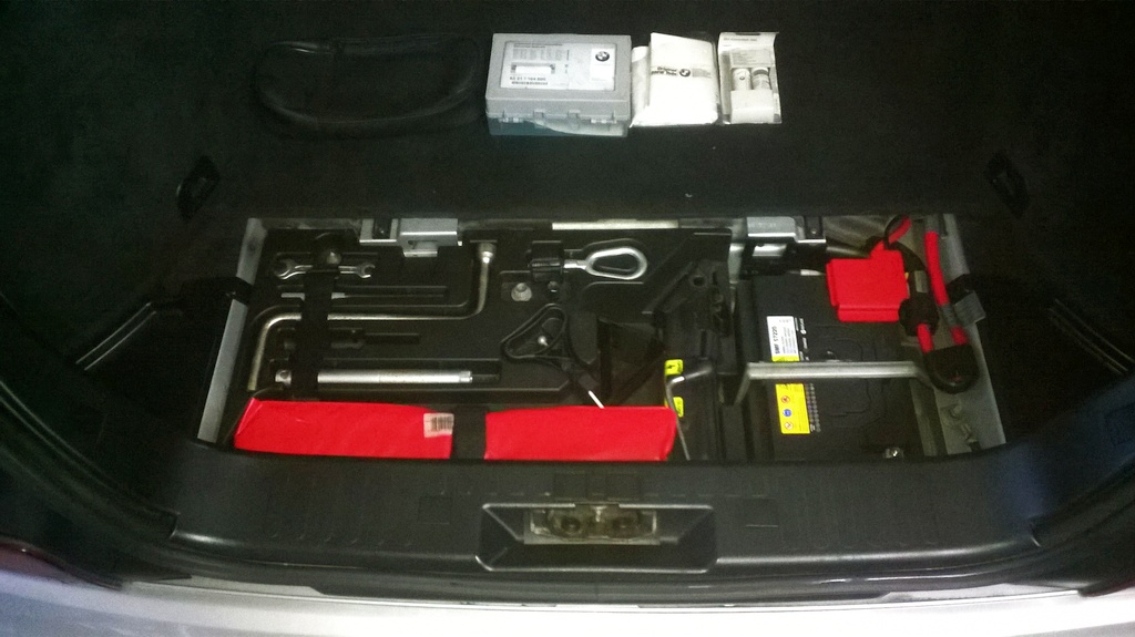

foto's met die foon helpen niet echt en is nog niet gewassen, maar hij ziet er heel goed uit, onder de motorkap ook en de M54 3.0 loopt mooi moet ik zeggen, en gaat er straks nog beter uitzien
zitten wel een aantal kleine parkeerdeukjes in, die wil ik er uit laten halen en 2 roestplekjes onder aan het voorscherm randje, nog niet slim, komt door steenslag daar tegen aan, afijn, ga ik ook aanpakken natuurlijk.

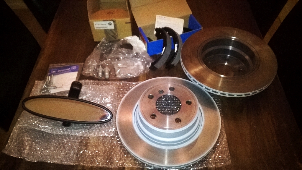

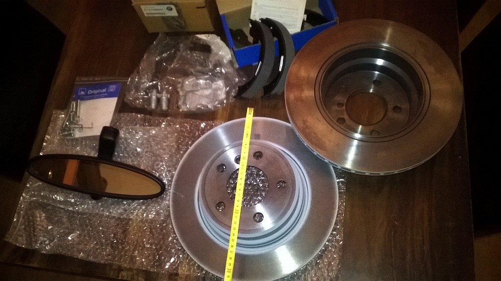

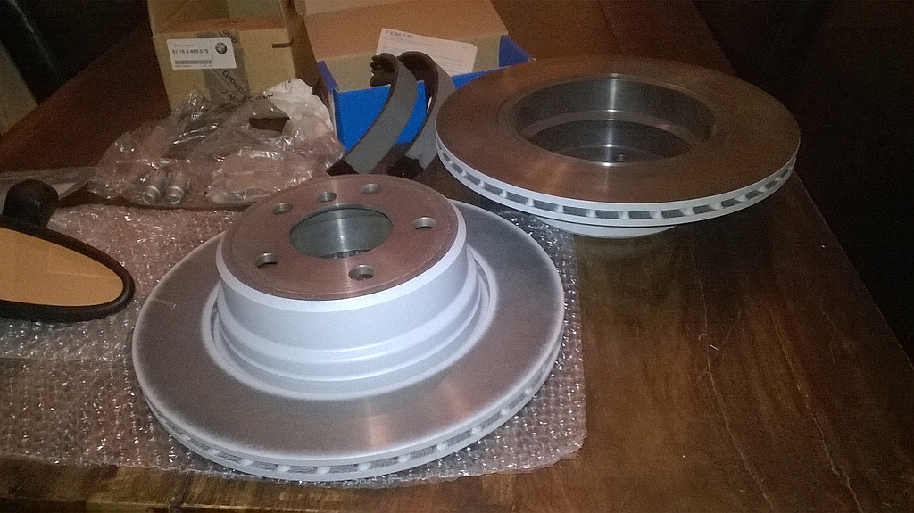

heb ook al wat remdelen binnen
lekker nieuw allemaal, ook remschoenen en veertjes en stellers en nog wat zaken achterkant.
die remmen zijn tenminste groot voor achter, nu zit er standaard 272 x 10 mm op
en die wat ik nu heb liggen 324 x 20 mm van Brembo

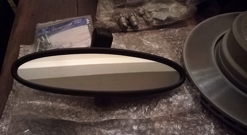

en de nwe M spiegel is ook binnen, mmm

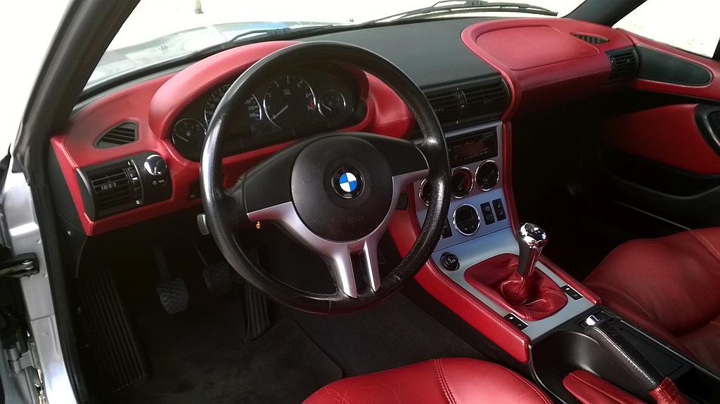

Mooi ding hoor, wat heeft ie gelopen? Zo'n stuur heb ik nog nooit gezien in een z3 coupe.
ik heb hem nog niet gepoetst ofzo, stuur wil ik ook nog met zo'n sponsje diep reinigen, ja natuurlijk voorzichtig.Will F. schreef:Mooi ding hoor, wat heeft ie gelopen? Zo'n stuur heb ik nog nooit gezien in een z3 coupe.
Er zit een heel omvangrijk pakket op die auto, om een par te noemen,
-ASC
-Airco
-Cruiscontrol
-Harmann Kardon
-Alarm klasse 3
-M set oid das pook en stuur en onderstel en en?
-Dat uitgebreide leer wellicht iets van indivudial ik kom niet uit dat woord en google fix heeft ook niet wat

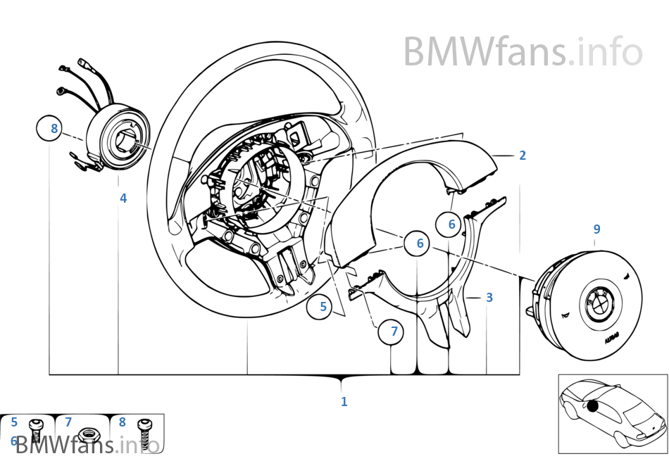

ah, deze zit er op
http://nl.bmwfans.info/parts-catalog/Z3 ... ve_covers/" onclick="window.open(this.href);return false;
Sportstuurwiel airbag met sierafdekkings
BMW Z3 3.0i Z3 coupe Europa M54
