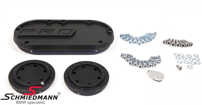

en anders haal je zoiets
http://www.schmiedmann.nl/3_series/E36/ ... tm#1952300" onclick="window.open(this.href);return false;
PRD Vanos block off kit S50B32 euro
