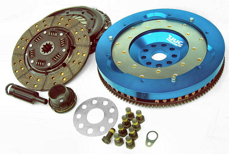

deze set(soort) schijnt minder of geen bijgeluiden te maken van Fidanza(UUC)
http://store.nexternal.com/shared/Store ... oducts.asp" onclick="window.open(this.href);return false;
zoiets zou ik denk kunnen gebruiken? klinkt goed...iets lichter betere respons alsof je meer vermogen hebt (krijg je niet alleen wordt het beter/sneller benut)"Moderate lightweight" flywheel and clutch combination for the E39 M5, 540i, and Z8 provides reliable clutch operation without excessive weight reduction. Excessive weight reduction causes the dreaded "transmission chatter" (also known as "gearbox rattle" or "rollover noise").
With the "moderate lightweight" flywheel, a significant performance improvement is still realized but without the annoying gearbox rattle... and all at a reasonable cost!
PRICING OPTIONS (complete kit including flywheel, clutch components chosen, all hardware, ignition timing plate):
1) Performance Organic clutch - high performance street/track use with greater clamping force and torque capacity. $1799
2) UltraSmooth CeraMetallic clutch - ultra-high performance street/track use with greater clamping force and torque capacity (recommended for "street drag racing" and highly modified / supercharged cars). $1979
The design of the "moderate lightweight" flywheel and clutch for the BMW V8 had to combine all of these characteristics:
13.5lb reduction is flywheel weight for faster acceleration and better throttle response.
No change in clutch feel or pedal effort.
Custom clutch with SAC elimination - extends durability of clutch to eliminate the unnaturally short lifespan of the original BMW design.
Clutch features "sprung hub" center for power pulse variation damping, an additional noise reduction technique.
Quiet operation with minimal gear lash sound.
Power-handling capabilities suitable for the original 394hp rating of the M5 with options for greater power levels.
Readily-available replacement clutch offerings.
volgens mij heeft @Paul ook zoiets gehad?
en wat is SAC ook alweer
