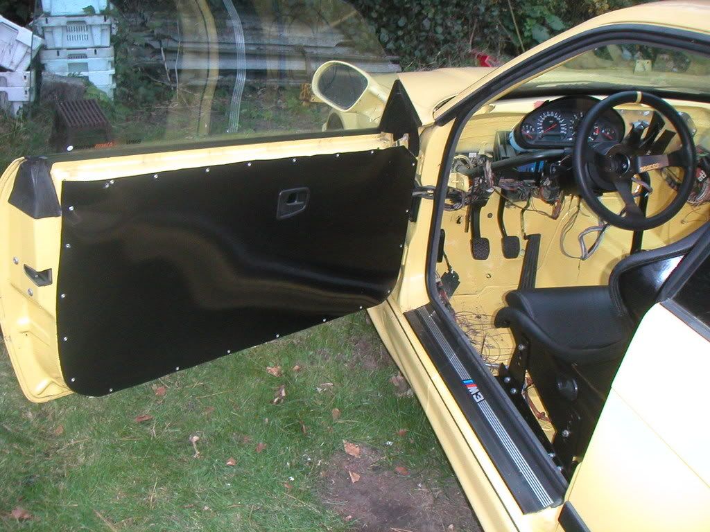

Pimp my car, deurpaneel versie 2:
[IMG
768]http://img.photobucket.com/albums/v240/ ... CT2794.jpg[/img]
[IMG
768]http://img.photobucket.com/albums/v240/ ... CT2795.jpg[/img]
[IMG
[IMG
