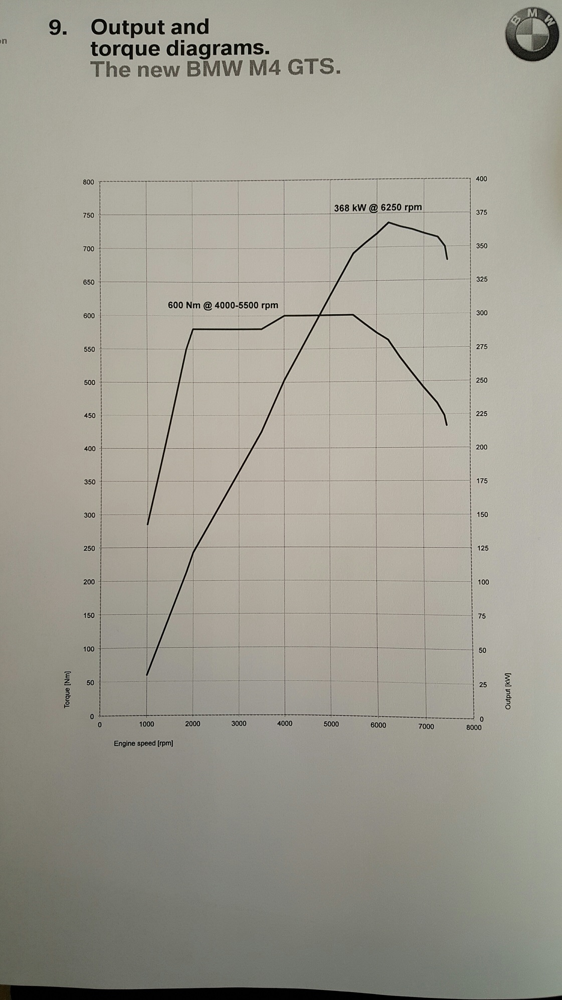

Extra info:
BMW
Media
information
10/2015
Page 29
BMW M4 GTS
Body
No of doors/seats 2/2
Length/width/height (unladen) mm 4698/1870/1383
Wheelbase mm 2812
Track, front/rear mm 1596/1604
Ground clearance mm 108
Turning circle m 12.2
Fuel tank capacity app ltr 60
Cooling system incl heater ltr 10.0
Engine oil1) ltr 7.0
Weight, unladen, to DIN/EU kg 1510/1585
Max load to DIN kg 390
Max permissible weight kg 1900
Max axle load, front/rear kg 975/1000
Max trailer load,
Braked (12%)/unbraked
kg ---/---
Max roofload/max towbar
download
kg ---/---
Luggage comp capacity ltr 445
Air resistance2 cd x A 0.34 x 2.25
Power Unit
Config/No of cyls/valves In-line/6/4
Engine technology M TwinPower Turbo technology: two MonoScroll turbochargers,
High Precision Injection, VALVETRONIC fully variable valve control, DoubleVANOS
variable camshaft timing, water injection
Effective capacity cc 2979
Stroke/bore mm 89.6/84.0
Compression ratio :1 10.2
Fuel min. RON 95
Max output kW/hp 368/500
at rpm 6250
Max torque Nm/lb-ft 600/442
at rpm 4000–5500
Electrical System
Battery/installation Ah/– 69/Luggage compartment
Alternator A/W 209/2926
Driving Dynamics and Safety
Suspension, front Three-way M coilover suspension with aluminium double-joint spring-strut axle
and M-specific elastokinematics
Suspension, rear Three-way M coilover suspension with five-link axle in lightweight construction
Brakes, front M carbon ceramic disc brakes vented with six-piston floating callipers
Brakes, rear M carbon ceramic disc brakes vented with four-piston floating callipers
Driving stability systems Standard: DSC incl ABS and M Dynamic Mode, CBC (Cornering Brake Control),
DBC (Dynamic Brake Control), Dry Braking function, Fading Compensation,
Start-Off Assistant, Active M Differential linked to Integrated Chassis
Management (ICM)
Safety equipment Standard: airbags for driver and front passenger, side airbags for driver and front
passenger, head airbags for front seats, three-point inertia-reel seatbelts on all
seats with belt latch tensioner and belt force limiter
Steering Electric Power Steering (EPS) with M-specific Servotronic function
Steering ratio, overall :1 15.0
Tyres, front/rear 265/35 ZR19 98Y
285/30 ZR20 99Y
Rims, front/rear 9.5J x 19 Light Alloy
10.5J x 20 Light Alloy
8. Specifications.
The new BMW M4 GTS.
BMW
Media
information
10/2015
Page 30
BMW M4 GTS
Transmission
Type of transmission Seven-speed M double-clutch transmission with Drivelogic
Gear ratios I :1 4.806
II :1 2.593
III :1 1.701
IV :1 1.277
V :1 1.000
VI :1 0.844
VII :1 0.671
R :1 4.172
Final drive :1 3.462
Performance
Power-to-weight ratio kg/kW 3.0 (4.1)
Output per litre kW/ltr 123.5
Acceleration 0–100 km/h sec 3.8
In 5th gear 80–120 km/h sec 3.0/3.8
Top speed km/h 305
BMW EfficientDynamics
standard features
Brake Energy Regeneration, electromechanical power steering, Automatic
Start/Stop function, Optimum Gearshift Indicator in manual mode, intelligent
lightweight construction, on-demand operation of ancillary units, map-regulated
oil pump, Li-ion battery, differential with optimised warm-up behaviour,
aerodynamics (Air Curtains, Air Breathers, underside panelling, front spoiler, rear
wing with gurney flap)
Fuel Consumption ECE3
With standard tyres
Urban ltr/100 km 11.1
Extra-urban ltr/100 km 6.7
Combined ltr/100 km 8.3
CO2 g/km 194
Emission rating EU6
Specifications apply to ACEA markets/data relevant to homologation apply in part only to Germany (weight)
1) Oil change 2) Provisional data 3) Fuel consumption and CO2 emissions depend on the selected tyre format.
