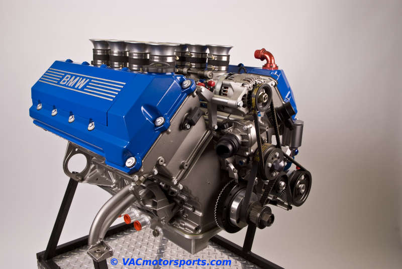

Je kan er NA heel veel uit halen, meer dan 500pk NA of zelfs bijna 600pk nog, dacht ik deze lui (VAC) hadden toen zoiets ook op het net staan, doch die gegevens zijn allemaal weg helaas (wordt ook al oud zo'n blokje)
http://store.vacmotorsports.com/vac---m ... p1448.aspx" onclick="window.open(this.href);return false;
of waren dat deze>
http://nowack-motors.de/bmw-5er-e39-motortuning/" onclick="window.open(this.href);return false;

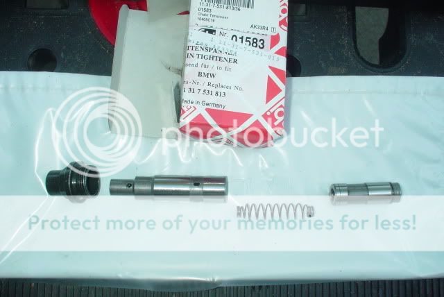

To sum this up, the M62 uses a metal timing chain guide where as the M62TU uses a plastic guide that can break over time.
Even if the M62's metal guide wears, it does a far better job than nothing at all.
Another point of wear is the "V" shaped guide that both the M62 and M62TU use.
The bottom of the V wears over time and causes the chain tensioner to extend until the end of its range, then the chain becomes slack.
The M60 is apples to oranges because it doesn't use that V shaped guide at all - it has a roller down there instead (oh, and it also uses a duplex chain like the S62).
If you do a search, you'll find the M60 has very very little issues with the timing chain...
The M62 doesn't seem to have problems either, but I'd be willing to bet we'll see more failures than with the M60. The M62TU is the problem child.

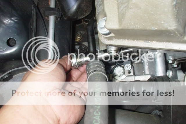

ook handig om te weten en ik ga die ook eens vervangen, niet dat er wat rammelt, heeft ook nog maar 94.000 km gelopen die motor van mij, maar is al wel aardig wat jaren oud ondertussen, dus ik ga die tensioner die je vanaf de buitenkant kan wisselen binnenkort maar eens to feel 'better'
lees>
is een heel draadje aan gewijd over de M60/M62/M62TU motoren>>The tensioner is what keeps the chain nice and tight.
As long as its tight, the only wear on the guides is the friction of the lubricated chain sliding across them. I pulled the head on my 145k mile e36 with a good tensioner a month ago,
and the plastic chain guide wear was minimal, if any.
But if/when the tensioner fails, the chain hangs lose, and whips and slaps the shit out of the guides, which breaks them down over time.
As jerkstore said, the tensioner is just a cylinder that screws into the side of the engine and can be replace in 5 minutes.
Likely the same or similar part, vanos or non-vanos. There may even be an upgraded part that can be retrofitted from the more recent V-8's. (EDIT: Not likely - BMW changed the whole chain set-up on later V8's).
I have not looked at the e39 unit, but typically, these things rely on a spring and oil pressure to pump-up and apply pressure to the chain rail - thereby keeping the chain taut.
http://www.bimmerforums.com/forum/showt ... uide-rails" onclick="window.open(this.href);return false;
