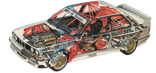

zat me al af te vragen of de group A DTM E30 ook anders waren....
what the main difference is between the group A and Group N e30 m3's? These two models,if I'm not mistaken were not sold, but only used as BMW's race cars? Am I mistaken? Let me know. Thanks again guys,
http://www.s14.net/forums/showthread.php?t=1637" onclick="window.open(this.href);return false;Just about everything is different.
The gr. N is "close" to stock class racing except
for gr. N suspension, stripped, cage, ca. 220 hp motor.
Gr. A or DTM cars had uni-ball suspensions, the chassis/cage
is competely different, gearbox, diff, gearbox & diff cooling,
entirely different engine internals, large oil pan or dry sump,
airbox & alpha N piggy back, later ECU4 and dual spark packs,
8 injectors, slide throttles, different radiator, different
exhaust system, different brakes and wheel hub assemblies,
air jacks, etc.
Its a very long list of items. If you look at the gr. A
cataluge almost every area of the car gets different parts.
even things like oil filter head, water pump, fuel pressure
regulator, fuel rails, injectors, spark plugs, pullies, steering
rack, to generator. various cams, valves, valve springs, tappets,
cyl. heads. different head gasket. various piston styles, from 3 ring
packs to 2 ring pack. short and long rods. even the crank is
different. different strenghtened engine blocks came later.
the rod and crank bearings are also different.
There were 7 types of S14 engine from motorsport alone.
From the 2.0L BTCC engine, DTM engines, to rally engines and hill climb engines.
back in the day, a sport evo cost roughly 90000 DM delivered.
A DTM car was over 300000 DM. Performance wise there is no
comparison of a gr. N to a DTM car.
A good driver may drive 8:40-8:45 lap on the nordschleife proper
in a gr. N car, a DTM car could manage 7:20-7:30 times.

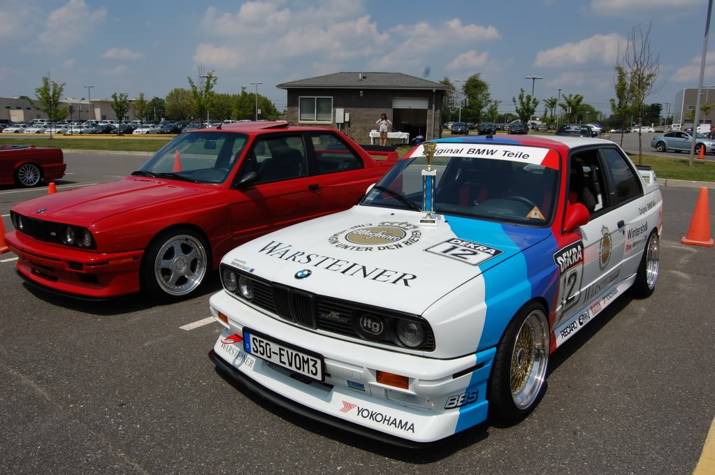

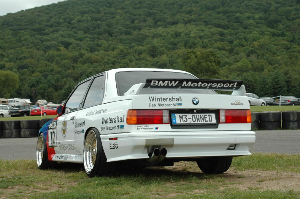

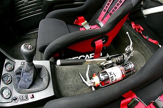

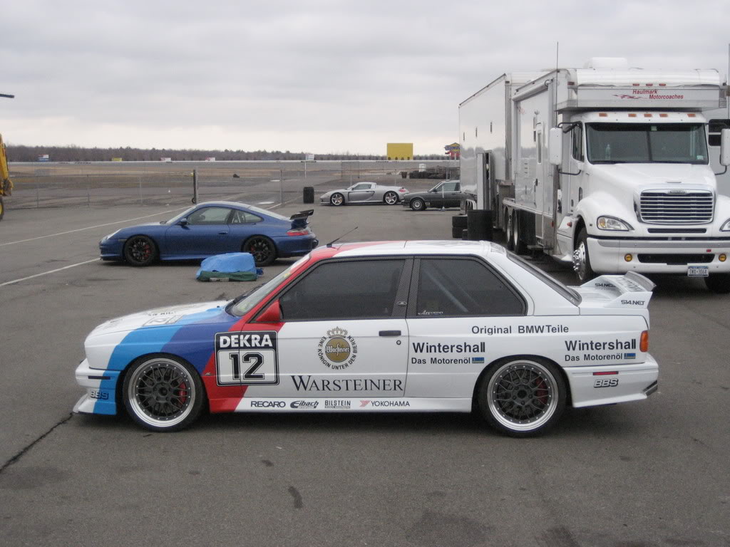

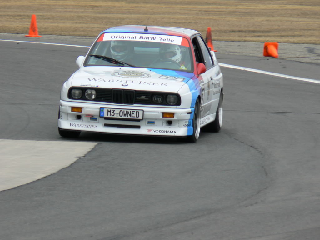

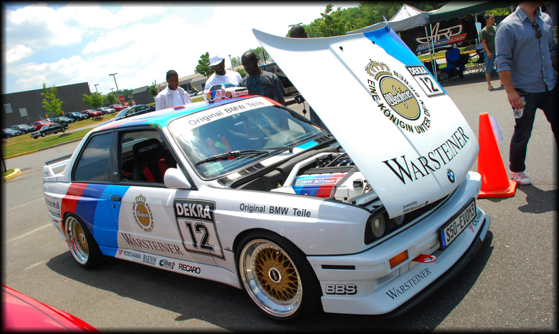

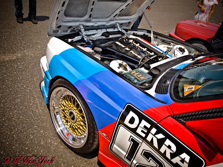

BMW E30 M3 DTM Warsteiner, 380HP AC Schnitzer Race Rep, 17″ BBS RS, Brembo, Recaro
meer>>
http://mybuildgarage.com/2010/10/bmw-e3 ... -the-best/" onclick="window.open(this.href);return false;

Tsjonge, die is even goed gepoetst zeg.
A tribute to the E30 M3 en er dan een zespitter inlepelen. Mmmmmm.
Re: E30 conversies and other BMW pre 1991 cars.
heilig schennis is het HielkeHielke schreef:Tsjonge, die is even goed gepoetst zeg.
zag trouwens net ook info van een group A DTM weinig gewicht en 320pk :banaan:

Rui's 700+ HP Turborcharged S54 e30 M3 took best of show
[imghttp://i100.photobucket.com/albums/m17/vlad-e30m3/Mt-Laurel-BMW-show-June19-2010/DSC_2986.jpg][/img]
meer>>it was funny to watch how this e30 destroyed heavily modified Porsche 997 GT3 on the highway going back home, the GT3 had no chance and was devasted
BTW that Porsche was supercharged also....

Een maat van me heeft ook zo'n Warsteiner M3 (buiten ander leuk speelgoed zoals een 964RS , 996 GT3RS en Z4 Alpina)
