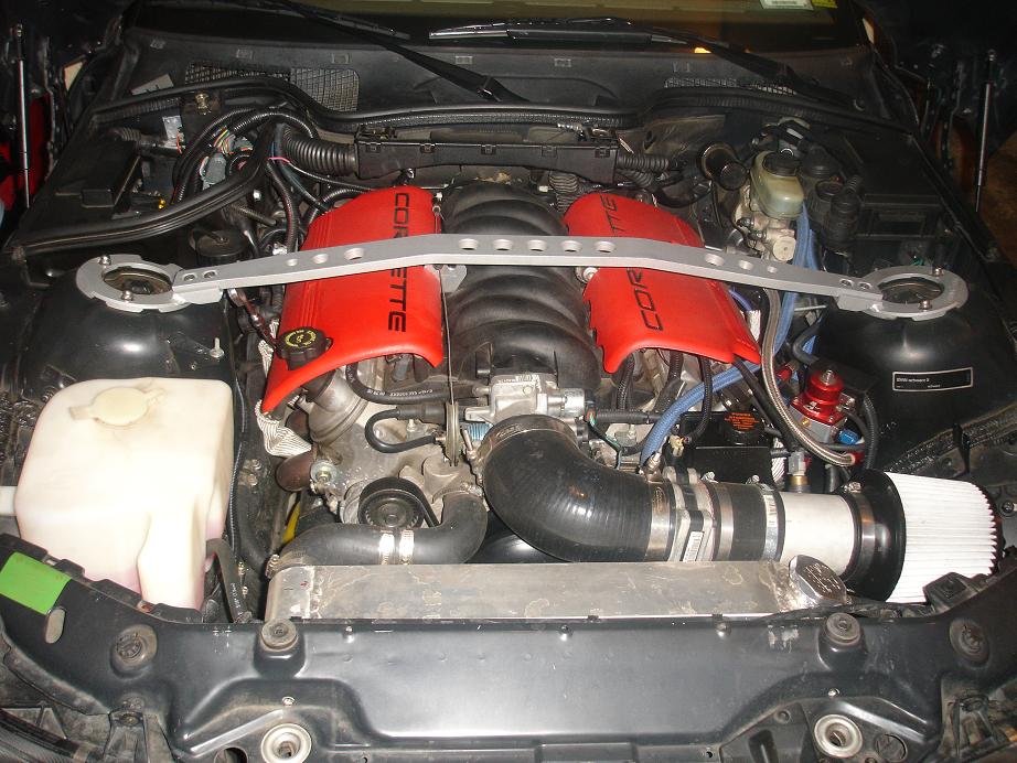

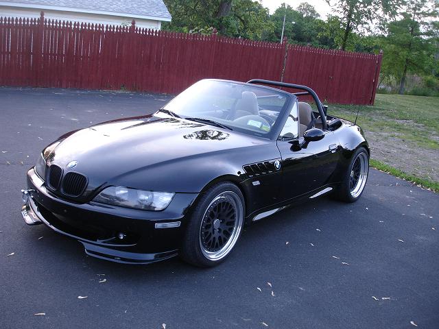

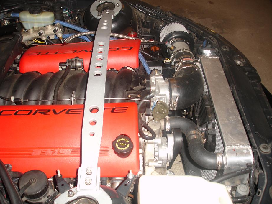

Het is maar een beetje e36 en het is niet pre 1991, maar het verdient nou ook niet direct een eigen draadje...
1996 Z3 V8 for sale
Vehicle
1996 BMW Z3
3/96 production
Jet Black
Tan interior
Chassis miles - 93k
Motor miles - 42k
Transmission miles 6k
Miles on conversion - 12k
Motor
2000 LS1
Stock heads
GM Hot Cam
LS6 valve springs
SLP hardened pushrods
LS6 intake manifold
ASP crank pulley
Water pump, alternator, starter, power steering pump all installed new at time of conversion
42k miles
Driveline
RPM Transmissions Stage IV T56
Centerforce Dual Friction clutch (12")
Fidanza 12.5lb aluminum flywheel
Upgraded OEM slave cylinder
Tilton 7/8" master cylinder
Remote clutch bleeder
Custom 4" aluminum driveshaft
e30 3.73 LSD with dual ear e36 M3 rear cover
Randy Forbes trunk floor/differential reinforcement system
Rebuilt e30 325 half shafts
6-12k miles on parts
Conversion Specific
NASH Motorspots e36 conversion motor mounts (modified)
NASH Motorsportse36 conversion transmission crossmember
Ireland Engineering polyurethane motor mounts
Prothane Polyurethane transmission mount
McLeod 4.1" T56 shifter extension
McLeod "S" shaped shift lever (modified)
Cooling
160 degree thermostat
Fresh OEM water pump
Custom dual core aluminum radiator
Dual electric pusher/puller fan setup

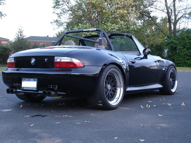

Exhaust
NASH Motorsports equal length long tube headers (1 7/8")
Magnaflow X pipe
Dual universal Cats
Dual Magnaflow 14815 mufflers
Exhaust diameter - 2.5"
12k miles on all parts
Electrical
LS1 PCM
Speartech custom wiring harness
Stock BMW gauge cluster with functioning speedo/tach/fuel/odom (reads 93k)
VDO water temp, oil pressure, oil temp, voltmeter
Optima red top battery (rear mount)
Integrated V1 (hardwired and concealed display in gauge cluster)
Walbro pump
Aeromotive fuel filter
Aeromotive adjustable fuel pressure regulator
Stainless -6 lines from pump to rail with Earl's fittings
Stock LS1 injectors
12k miles on parts
Brakes
Front e46 M3 slotted rotors
Front 4-piston WIlwood calipers
Front Hawk ceramic pads
Rear OEM rotors/calipers
Rear Axxis Ultimate pads
Front/Rear stainless lines
Mustang hydroboost brake booster
Suspension/Steering
TC Kline single adjustables (450/500)
e36 M3 strut mounts (swapped for camber)
TC Kline polyurethane rear shock mounts
Powerflex polyurethane control arm bushings
Ball joints, tie rods, rear trailing arm bushings, swaybar bushings and endlinks - all replaced with OEM in last 6k miles
6k miles

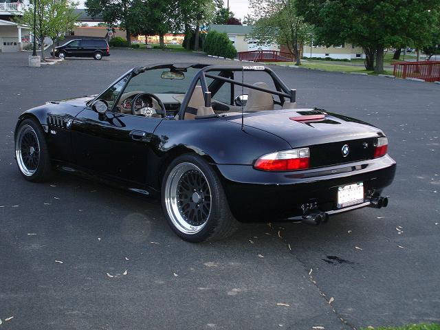

Wheels
Front CCW Classic 18x8.5"
Rear CCW Classic 18x10.5"
Front Falken FK452 245/35/18 (6k miles)
Rear Falken FK452 295/30/18 (6k miles)
Body
M Roadster/Coupe front bumper cover
M Roadster/Coupe side mirrors
M Roadster rear fenders
M Roadster rocker panels
6cyl Z3 (early) rear bumper cover
OEM Hardtop (currently painted Cosmos Black)

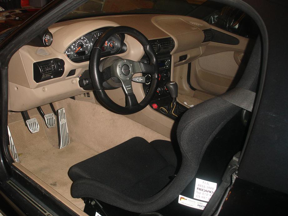

Safety
Recaro Pole Position seats
VAC aluminum seat mounts
OEM Passenger seat included
HMS 4pt rollbar
HMS harness bar
• Any wear part directly/indirectly related to the swap has been replaced within the past 12k miles
• This includes motor/tranny bushings, control arm and sway bar bushings, ball joints, tie rods, strut/shock mounts, rear trailing arm bushings, subframe bushings, brake pads, brake fluid, brake lines, fuel lines, filters….nothing has been overlooked.
• Over $40k invested in parts since 2005
Asking $28,900

Re: E30 conversies and other BMW pre 1991 cars.
Bericht door GTRene » 11 jul 2010, 12:02
vind hem er wel heel vet uitzien :thumbup:
mooi ding 8)
Jules
Berichten: 1975
Bericht door Jules » 11 jul 2010, 12:32
hehe toch wel prachtig zoiets.... zal wel lekker vooruit gaan :mrgreen:

denk dat dat soort velgen ook wel mooi op een M3 e30 zullen staan :hmmm:
Bericht door peter87 » 11 jul 2010, 19:29
zoo! daar zal een aardige schoenlepel aan te pas gekomen zijn!
knappe prestatie!
bijna een beetje shelby cobra achtig concept, lompe amerikaanse v8 in een licht europees chassis.
zal wel lekker rijden lijkt me!

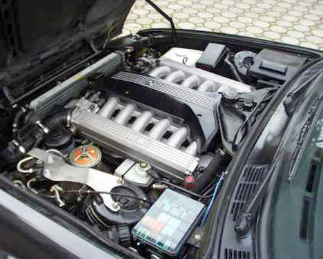

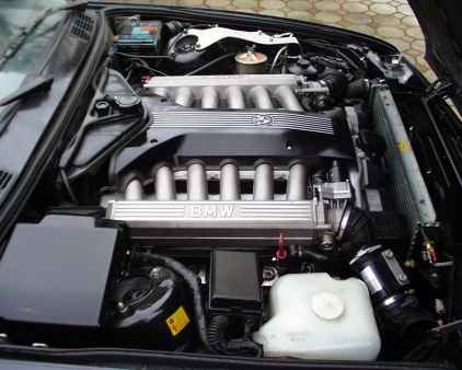

zocht net schanieren/grijpers van een e30 kom ik deze tegen...beste jongen :D
weet niet of ie er al tussen staat, but so be it.
V12 Powered E30 BMW
We’re big fans of modified cars. Especially the ones that don’t brag about the power they’re packing. This classic E30 3-Series fits the bill – perfectly.
This monster is owned by German BMW fan – Robert Stelzenberger. In his quest for crazy power, Robert decided to look to the 3-Series’ big brother – the 850i. The 350 bhp V12 unit uses a back axle from the M-Roadster to transfer its power to the road. Underneath, an E36 M3 donated its suspension and brakes for the cause.
hier meer
http://www.bmw-power.de/Fahrzeuge/E30_3 ... rsicht.htm

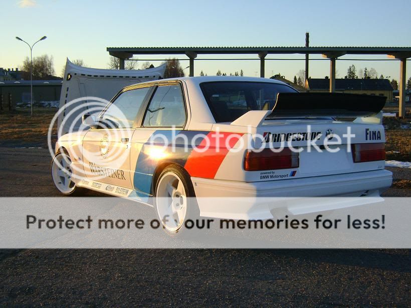

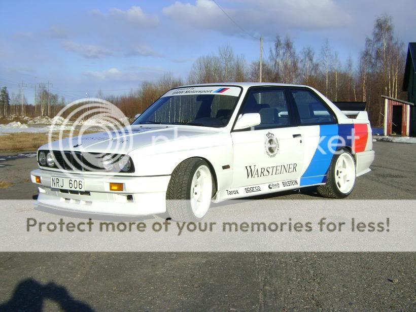

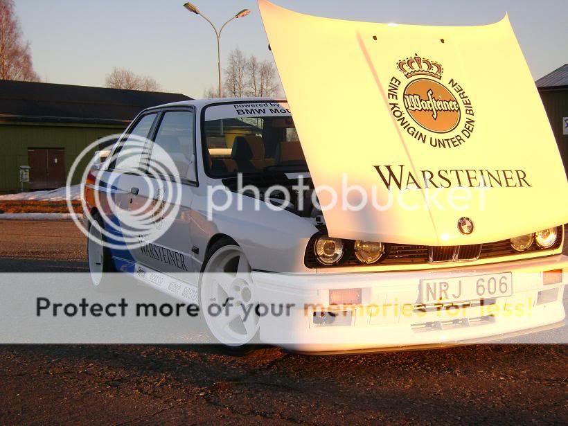

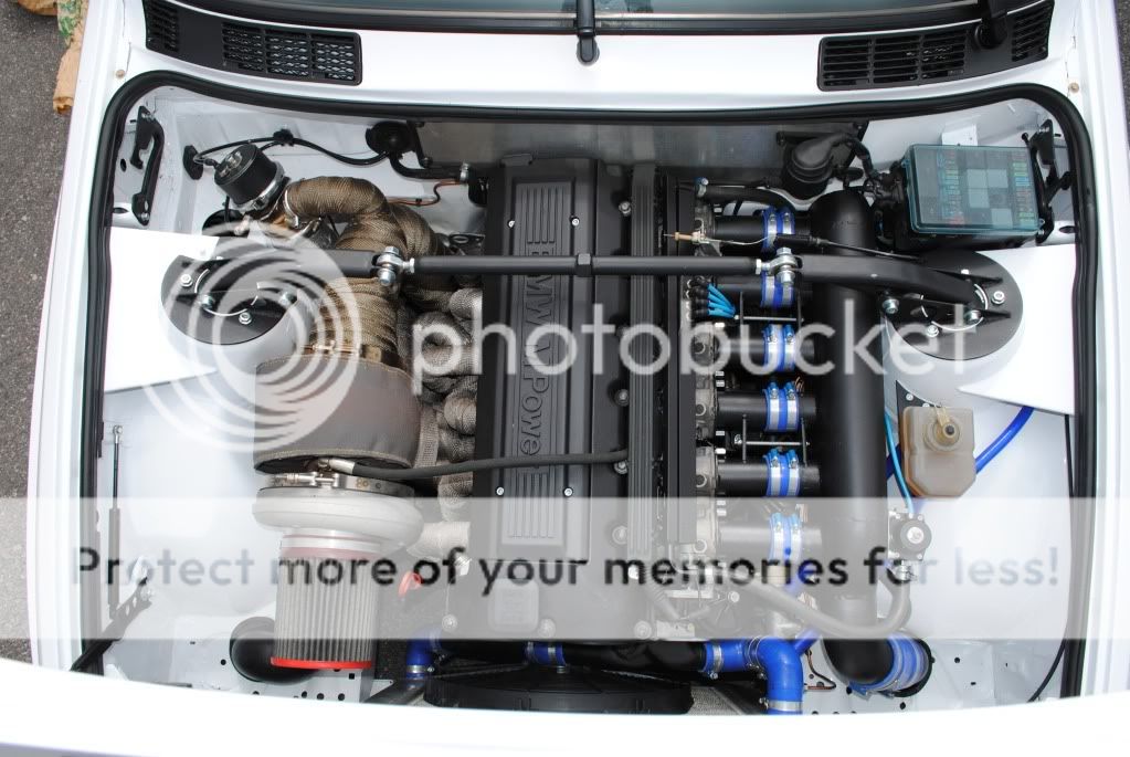

Bij deze staat geen prijs, maar dit is ook geen stakker :-) Althans, dat denk ik, mijn Zweeds is wat roestig...
BMW TURBO 790hp 950nm at the wheels
motor:
helsmidd s50b32
wiseco 86,50 med kolvbultar i verktygsstål
spm stakar
arp topp, ram , vev
portad topp
pyramidringat
eget tråg och motorfästen för 6 graders lutning
eget insug
eget grenrör
60mm wg
1680cc spridare
3* 044 pumpar
2*50mm dumpar
BW 475 med 4" downpipe
bmc filter
griffin kylare
ic 350*600*100
vi-pec v44 med vag spolar
lättat m10 svänghjul med tilton
tilton slavcylinder
drivlina:
TREMEC TKO600
mellanaxel i 84mm cromemilly
skåttsäker bakvagn med M5 diff och sviktaxlar
och justerbara hjulvinklar
kaross:
M3 org framskärmar bakskärmar baklucka sidokjolar c-stolpe och stötfångare evo vinge med kolfiber läpp, kolfiber splitter
Fälgar: azev 8*17 fram 10*17 bak
Däck: 215/40-17 fram 235/40-17 bak
Bromsar: 330mm runt om
inredning: hel och fin m-tec tyg
mm mm
bromsad på ppf till 790hp och 940nm på hjulen
meilar mer bilder vid intresse
bilen går grymt bra
pris: bud eller byte + pengar
kom med förslag
Bericht door GTRene » 19 jul 2010, 20:00
mooi clean :clap:
en ja, denk niet dat je meer dan max 500pk in zo'n ding wil :D
afijn, wel leuk/mooi om te zien hoe tuners zaken oplossen om sterker te maken.

apart ook trouwens dat bij die witte s50 turbo m3 geen intercooler is gemonteerd, als je zulke bedragen gaat uitgeven zou een intercooler er toch wel bij kunnen lijkt me? het is natuurlijk ook wel een welkome winst die koude lucht
