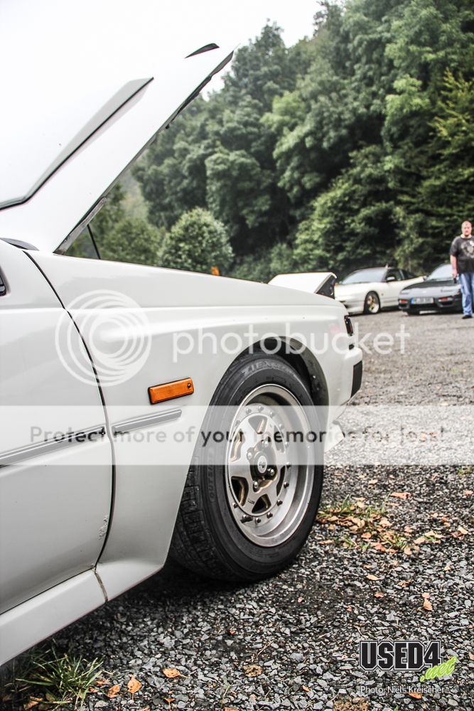

De velgen zijn de originele velgen voor dit model met bodykit. Ik ben het met je eens dat de velgen te ver in de wielkasten vallen, maar dat komt tzt nog een oplossing voor.

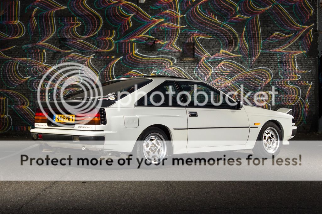

[size=14pt]Spotlight: The art of the S12[/size]
We of Wangan Warriors are all into everything regarding the Japanese automotive culture out here. That means we are no strangers to some of the most classic models and projects. Actually, we adore them! This beautiful Silvia S12 Grand Prix rolled of the lot in 1986. Twentysix years later it is owned by gearhead Mark van der Velden. His life is all about travelling to visit race circuits and drive them. He’s also a Nurburgring addict and thats where we did this photoshoot back in August at the annual nissan Silvia meeting in a small village near the famous Nürburgring.
Mark changed quite a bit on the Silvia since he imported it. In February 2011 he picked it up with a trailer in Stützengrun in Germany which is near the Czech border.
After a few months the engine blew up because of a coolant failure so Mark needed to fix that with an engineswap.
The FJ20e under the bonnet runs about 145 hp with 184,4 Nm of torque. In the interiour there are Recaro recliner seats with a 4 point QSP safety harness.
When I took a further look at the interior I was expecting a sport steering wheel as well but the Swiss edition S12 comes with special Grand Prix steering wheel, German ones just got the stock S12 steering wheel like these.
Because driving on a circuit is no joy without some handling modifications, Mark installed a BC racing coilover setup on his car. And on the front there is also a s13 strutbrace customized to fit the S12. There are also S13 facelift brakes with DS2500 brake pads mounted instead of the stock brakes.
Mark didn’t do anything fancy with new wheels but is running on OE Grand Prix Edition Gotti 3- piece rims. With 7j on the front and 8j at the back.
As you can see Mark is not scared to drive overseas. Some people would be paranoid after some big engine failure and would only go to places or meetings near their hometown in case anything happens. Mark is almost a regular at JAE.
The GP edition Silvia is quite exclusive. However the exact numbers today are unknown. Nissan Germany says that there are 4.400 sold in total. Most people doubt these are all Grand Prix’s, others say only 50.
Mark has been an active forummember of ours for a long time and off course he’s got one of our stickers on his ride. In fact it’s an honour to see it next to the Japan support sticker which were designed after the tsunami in 2011.
Another cool detail about this car is that even the models in 1986 had headlight rain wipers. Even the later Silvia models don’t have those, how cool is that!
Mark made me open my eyes for these classic Silvias and this will sure as hell not be the last feature we will share of a cool classic JDM car. I would also want to say to all the classic owners out there that if you read this, feel free to drop by our end of year meeting. We’re not only fond of performance and stance orientated cars but we love classics as well!!
I know for certain that Mark will visit some tracks in the future and if I spot him out there I will try to capture him! Thanks to Mark for his enthousiasm and activity on our forum. I had a lot of fun at the Silvia meeting in august! Hope you appreciate the spotlight blog.

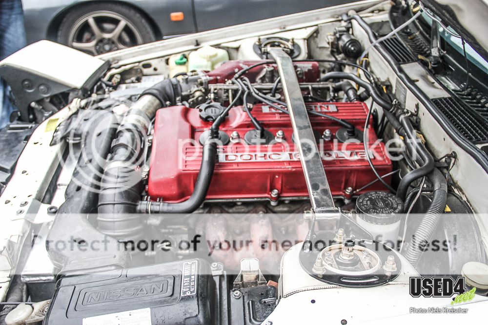

Vorig jaar had ik weer een lekkage aan een kvs slang. Toen was de maat vol en besloten alles eraf te halen en na te laten maken. Na een tijdje eindelijk in de UK een bedrijf gevonden dat slangen namaakt en geen 1700 euro vraagt. JSperformance http://www.jsperformance.co.uk" onclick="window.open(this.href);return false; kan slangen namaken in de gewenste vorm en hoeveelheid voor een redelijke prijs. Wil je hierover meer weten dan mail John van JS Performance maar.
De slangen zijn van siliconen gemaakt en zijn iets dikker aan de buitenmaat dan origineel. De meeste slangen pasten goed, alleen de 2 slangen onder het inlaatspruitstuk hebben een te grote buitendiameter waardoor de slangklem er niet goed over kan om het af te sluiten. Daar zit dus even tijdelijk een QSP slang.
Wat fotos
Oude slangen
Nieuwe silicone slangen
Nadat dit gemaakt was kon de S12 weer rijden.

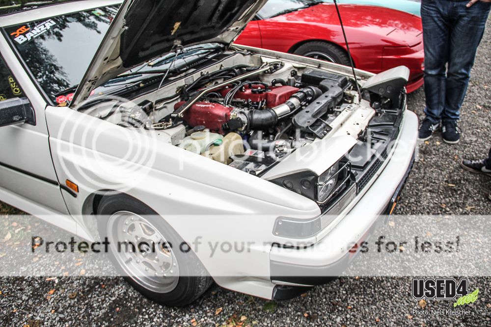

Ben ook nog naar de UK geweest, voor de vijfde keer naar JAE.
S12 FJ20 en K10 SR20

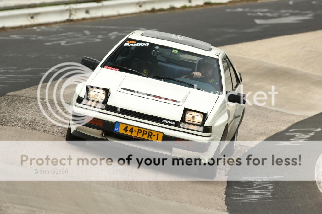

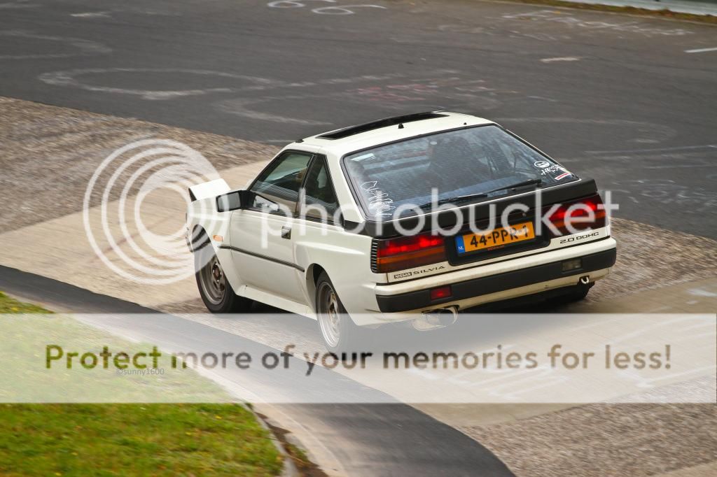

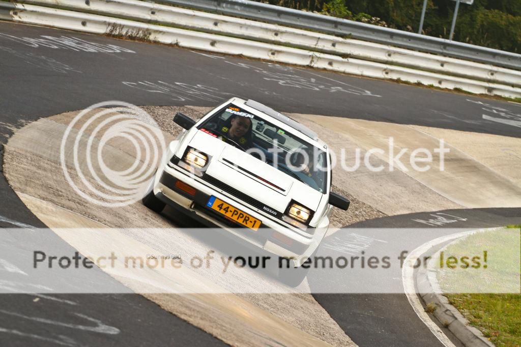

Daarna ben ik 2 keer naar de Nurburgring/Nordschleife geweest met de S12.
De eerste keer was tijdens de Nuermeet van SXCE.org en hier ben ik nu voor de 2e keer met de S12 geweest. Altijd veel plezier daar, ondanks de kou in de Eifel en de bronstige herten.
Ik heb maar 2 rondjes gereden in de morgen, en het was te druk om fatsoenlijk te rijden die zondag. Zie de foto hieronder.
Tweede keer was een goede week later, op een rustige maandag. Lovely to drive it then. Drie rondjes gedaan en toen besloten dat het goed genoeg was geweest. Koppeling gaf wat problemen, bak maakte meer herrie dan een F16 op oorlogspad en als ik zelf zo doorging dan ging ik samen met de silvia het bos in.

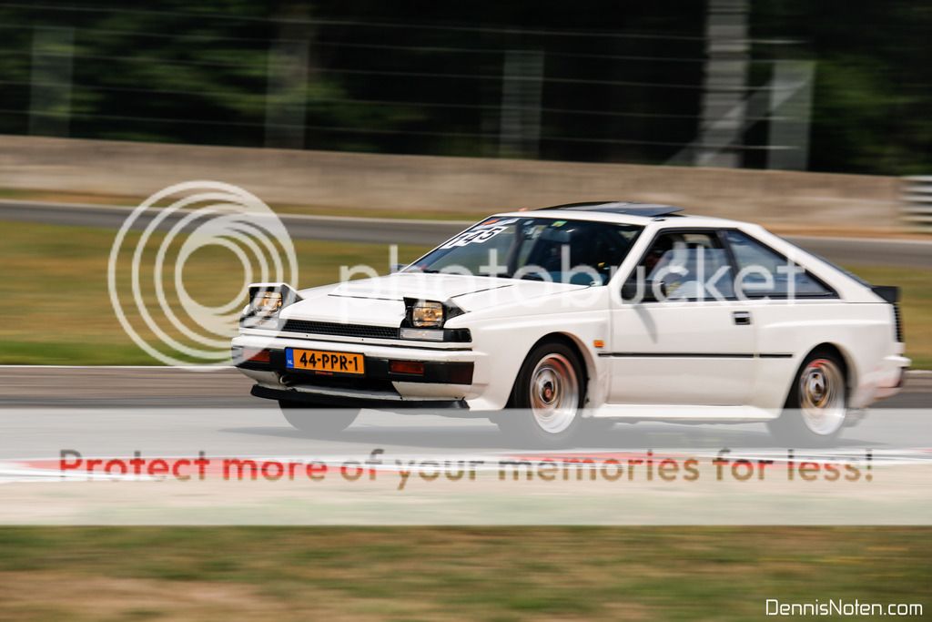

Hierna ben ik een middagje naar CPZ geweest om een sessie te rijden. De baan is zo breed tov de ring. Helaas geen fotos of video's, wellicht de volgende keer.

Gisteren samen met een maatje wat fotos van de silvia gemaakt.
Iets om de sleutels aan op te hangen.

Op de Nurmeet
Nog even een schrikmomentje gehad. Ze vroegen of ik even wat gas wilde geven dus zo gedaan. Sprong de gaskabel van de hendel af en ging het gas ff vol open staan.
Resultaat staat hierboven.

Zondags dus naar de ring gegaan
Het was behoorlijk mistig.
Wat fotos van op de ring

Op 12 Augustus ben ik nog even snel een uurtje wezen rijden op Zolder via skylimit/trackday by Heinz. Voor 75euro een uur lang kunnen rijden op Zolder. Het is een vrij klein circuit, 10 bochten en zo'n 4 kilometer. Maar wel een uitdagend circuit, vooral voor je remmen. Na een half uur de auto ff 5 minuten stilgezet in de pits want het stuur trilde behoorlijk tijdens het rijden. Misschien zijn de remmen wat te heet geworden of was het opgepikte rubber de oorzaak. Geen idee maar de rest van het uur heb ik er bijna geen last meer van gehad. Al met al een leuke middag gehad, het is ook maar een uurtje rijden vanaf Eindhoven dus goed te doen. Dennis Noten heeft nog deze fotos gemaakt.
En een klein beetje videomateriaal. De Gopro vond de lucht leuker om te filmen
