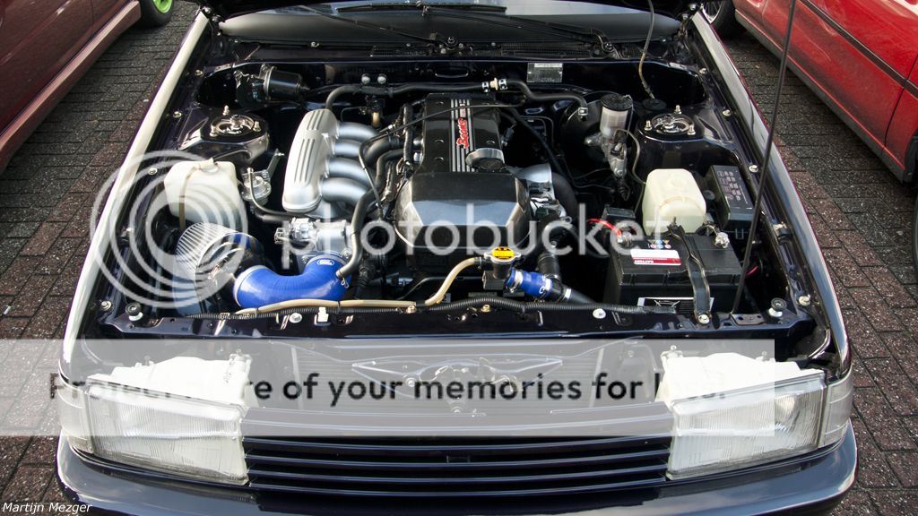

One more thing I did is reroute the loom on the engine.
It was not how I wanted it to run so I needed to change.
Plus I used vulcanizing tape now, so it looks alot nicer too :)
And an overal view as it is now:
