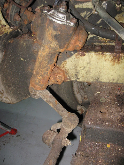

The bad bits: She's rotten... very very rotten. engine was dead, but she was "freshly" painted... although not in the way we like it.
the engine bay:
well, let's get her inside and start tearing her apart so we can have a good look at how bad she rly is.
nothing a bit of paint can't fix.... right?

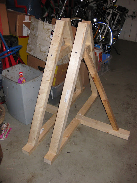

In order to do all the welding it would be usefull to be able to turn the car on it's side or upside down.
so we made a set of A frames from wood.
wood? yes... wood. plain simple cheap timber y0
the hinges:
and bolted on the car:
makes working on the sides and bottom sooooo much easier

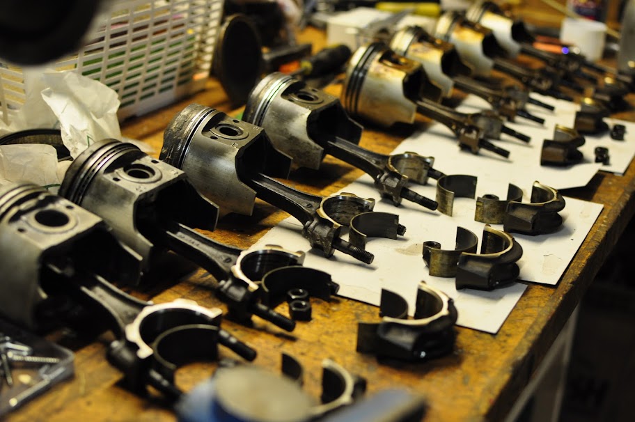

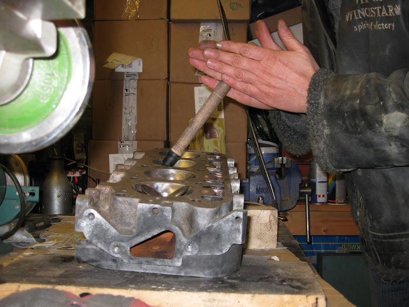

work continued on the engines and he was doing a bit of headwork, flowing ports, seating valves etc.

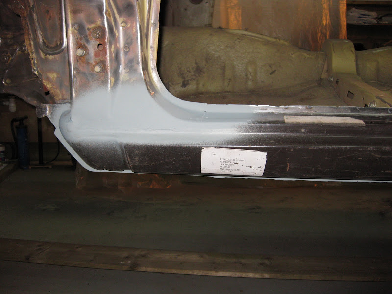

replacement sills going in

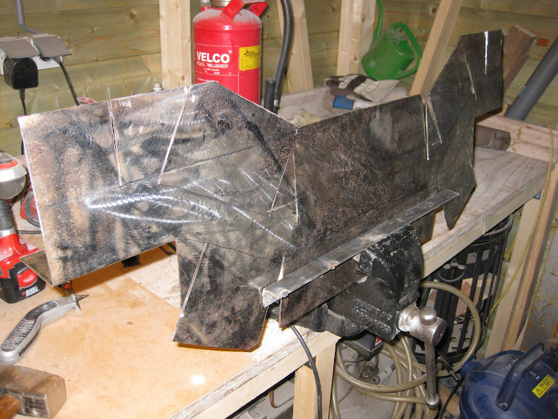

the old radiator support was too far gone. so JW (my friend) made a replacement from scratch
and now for some tasty engine pics.
as we had 2 engines to play with we had plenty of choice in parts

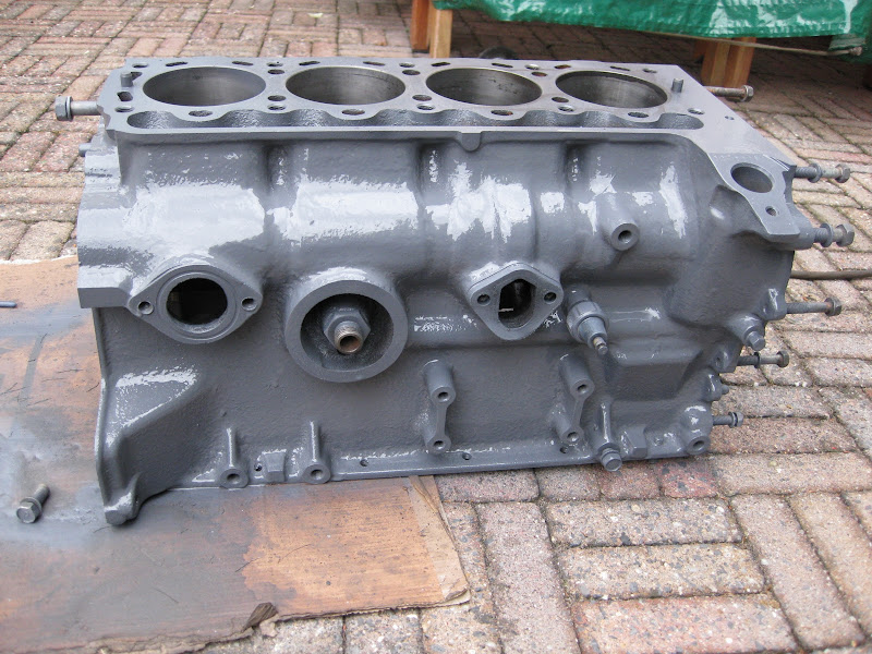

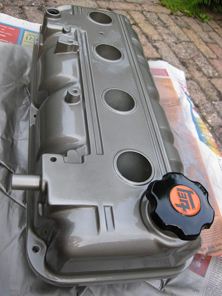

prepped and painted block
preparing parts takes soooo much time but the results are hard to argue with

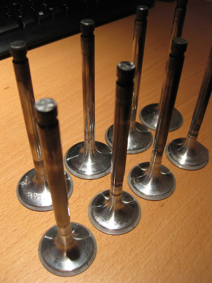

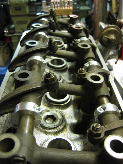

JW coulden't resist doing some custom valvetrain work and replaced the spring system with clamps

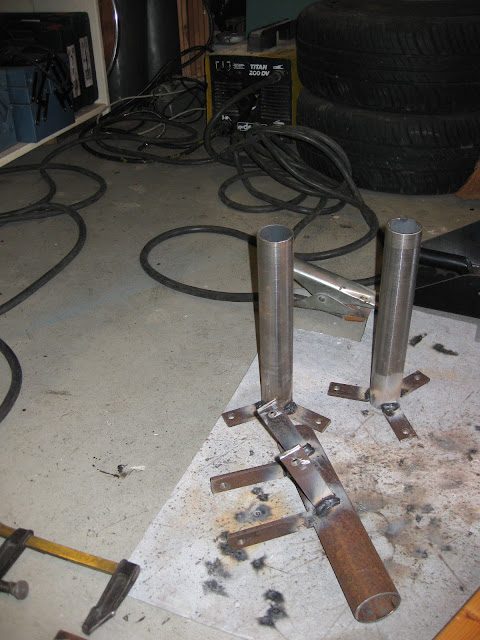

By doing so there was a need for roll center adjusters.
Why buy if you can build it yourself?

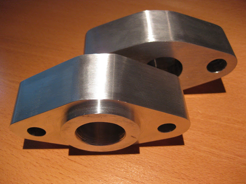

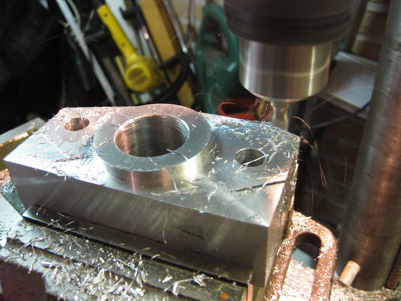

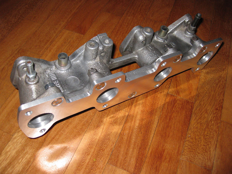

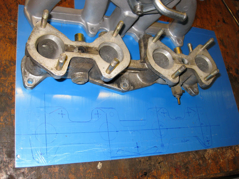

Found a set of Mikuni carbs instead of the ori single carb
too bad they didn't fit :(
so let's create an adapterplate :D

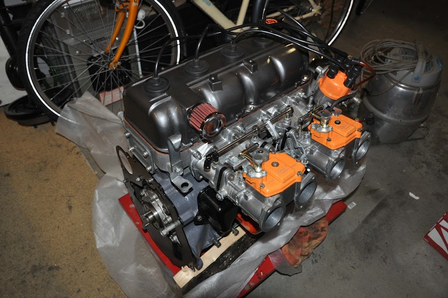

engine comming along nicely :D

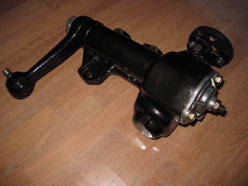

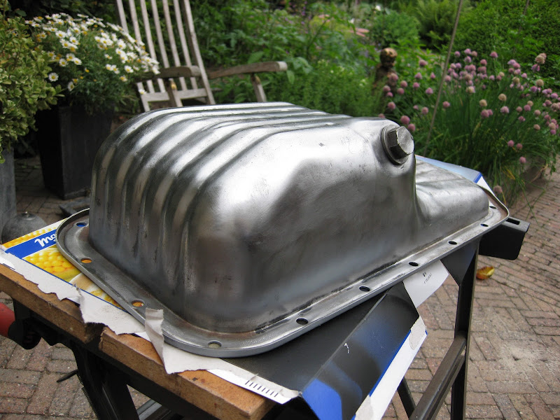

in the meantime bit by bit is getting a full makeover. often little parts are overlooked like door hinges etc.
but JW is restoring each and every single part.

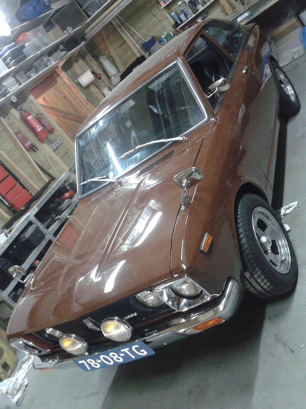

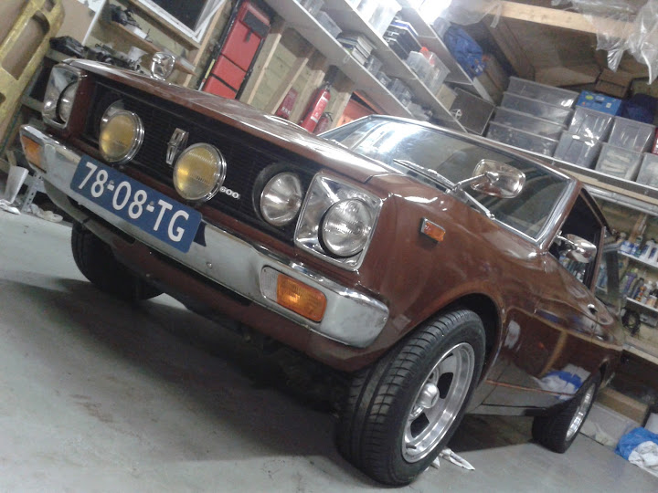

and at last! she moved out of the garage under her own power for the first time.
made a short testdrive around the block and she's running well :) very easy car to drive

(de plek van de bobine i.c.m. de carb kelk vind ik niet zo handig gekozen)

De opmerking over de bobine lijkt me overigens terecht. Misschien preventief toch een stukje verder weg plaatsen.

de bobine zullen we nog wel verplaatsen :)

Bericht door Rage » 24 mei 2014, 16:17
vliegwiel is zeer goed uitgebalanceerd :) hij is nu erg rev happy :D
