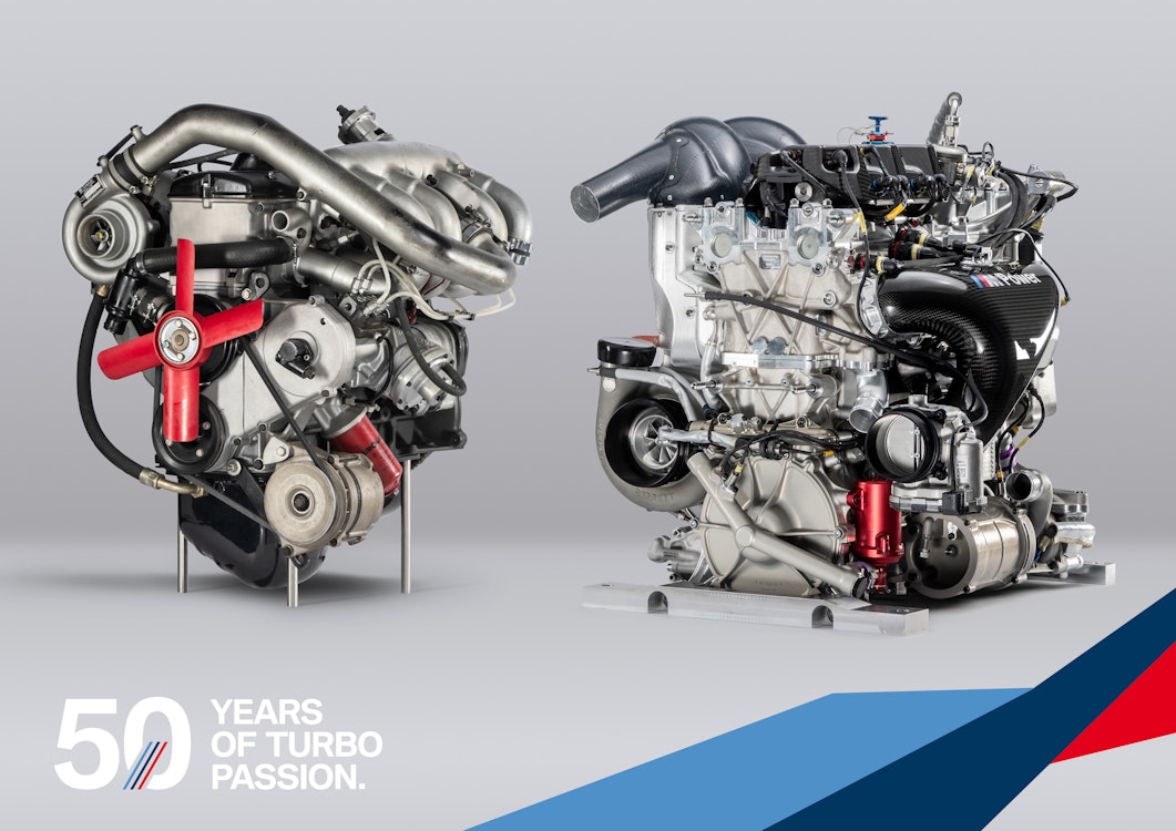

Hier maar even. FWD in 'n BMW is wennen(ik hoef 'm niet!), maar als ik dit dan weer zie. Kolere 9500rpm, 600pk 2 liter, nieuwe DTM regelgeving.
Met foto's van opa M121 vs junior P48. Machtig mooi blokje:
https://f87.bimmerpost.com/forums/showt ... st24701585

^Schitterend blok qua techniek, verdient wel een eigen draadje

Mooi stukje om te lezen Robin! Dank!
The turbo charger in the P48 supplies the engine with 400 litres of air per second – 3,500 times as much as a human breathes. The pistons accelerate from zero to 100 km/h in less than a thousandth of a second – 1,200 times faster than a lunar rocket. The water pump shifts roughly 18,000 litres per hour. This is fast enough to fill a bath tub in roughly 20 seconds. 1,005 drawings were made for the final assembly of the engine, which consists of roughly 2,000 individual parts. Laid next to each other, they would cover the floor of a 250 sqm apartment.
